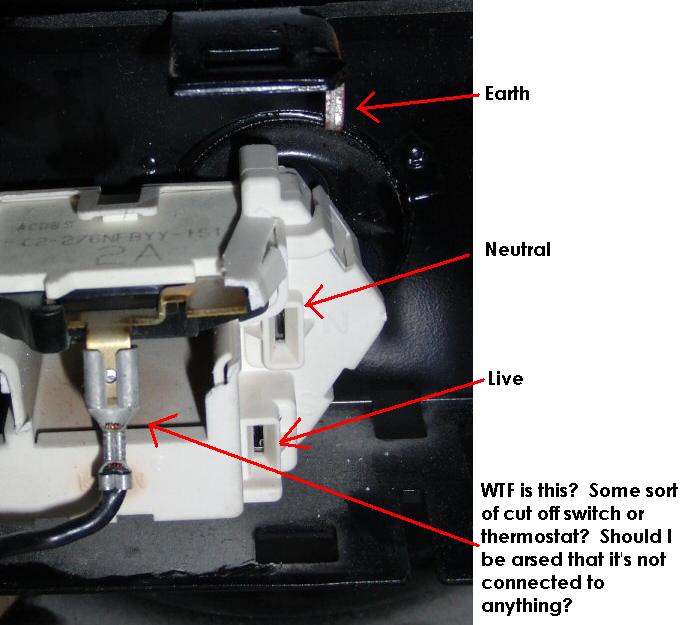

I also has fridge compressor and no skillz!
Do I add a switch to the thermostat cable and run it as such? Can I just bridge the thermostat circuit so it runs whenever I plug it in?

Both would be ok.... though IMO it is better to have a switch, as it's more convenientDo I add a switch to the thermostat cable and run it as such? Can I just bridge the thermostat circuit so it runs whenever I plug it in?

The short answer is NO. The start winding is offset 90 degrees from the main winding. It's only purpose is to pull the rotor off center to impart rotation. Once up to speed, the magnetic field induced in the rotor goes back and forth at the same rate the applied AC power pushes it. The very high power the start winding draws will burn it out in less than a minute in many cases, or you will blow a circuit breaker. It does not add high power torque to the compressor once it is up to speed.Do you think it would be possible to use the starting winding to get more power? (for example if you want to achieve higher pressures)
That would probably require an efficient cooling system...
Some compressors are designed to have a limited current in the start winding after it is started. The start current and run current and phase shift for the magnetic angle required is done with run and start caps. This is often seen on high start torque high power compressors for central air conditioning.
This diagram shows a typical Capacitor start diagram. The Capicator phase shifts the current in the start winding and that switches out after the motor comes up to speed.
A start run setup uses a high value start cap and then switches to a low value run cap. This setup is often used on larger compressors and may work for a fridge. You will want to use a much smaller cap as you are using a much smaller compressor. The compressor and cap need to be matched in size.
Do not simply connect the start winding to power without a cap and leave it on. It will burn out the winding.
Try using a 4MFD 350 volt run cap.

Before I plug this in, have I got it the right way round?
edit: looking at the previous photo before I ripped everything off, it seems I have got it wrong. The loose black wire should be live, yes?

hard to say.... but it was attached to something before you started playing with it, right ? check what it was
check my edit, it was live
and I was compressor! woo!
Very disappointing whirring noise, is it meant to be so quiet? Or does it get louder under load?

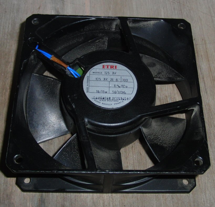

While we're asking 'lectric questions, I have this rather nice cooling fan, I presume it's an AC motor but no live or neutral markings on the pins and the wires aren't colour coded - does this mean I can connect it either way?
