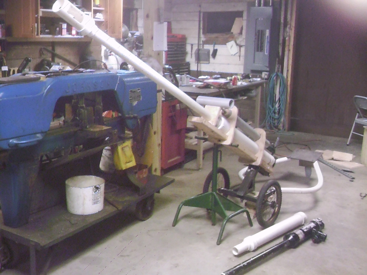

Ok fellas, I've got an odd one for you.
So I've been working on this howitzer. It's supposed to use shells instead of being muzzle loaded, so the system is fairly complicated which... complicates things.
Here's a load-out of my system:
-Spark plug ignition, which is an actual spark plug with the ground electrode ripped up so the gap is much larger.
-One barbecue button as an electronic initiator
-hinged "door" which completes the circuit upon closing
The pictures are gonna explain this a thousand times better than I am now. My problem is getting a consistent ignition. I've gotten it to work with light loads and small charges of hairspray, but I got nothing when I went to do a full blown test. I know I can get an arc using the spark plug and through my circuit, and I've tested the connections while the shell is in the tube.
SO since I've got a bunch of experienced spudders out there, I need some suspicions and suggestions. I have a few theories:
A) The door system I am using causes too much resistance, and the current at the spark gap is not hot enough to ignite large doses of gas
B) By spraying gas in the front of my shell, I am not getting the gas all the way to the back of the combustion chamber, thus the spark never gets near enough to ignite the gas
C) By spraying gas in the front of my shell, my spark plug is getting wet, shorting out... or rather unshortening, my spark gap.
My dilemma is I do not want to abandon my shell-fed system, nor my door. Yes, I could turn this thing into a regular spud gun, but I've already got one of those. This **** makes you feel like a redleg, haha.
Any help is appreciated
Matt P
PS Here's the link to the rest of the build. It's just a bunch of pictures, and my feeble attempt at rifling the barrel.
https://www.facebook.com/media/set/?set ... ploaded=10
This is the door and the back of the shell
That's the best picture I have with the shell out of the chamber
Here's the whole dang thing compared to a regular potato gun, with a shell next to it.
