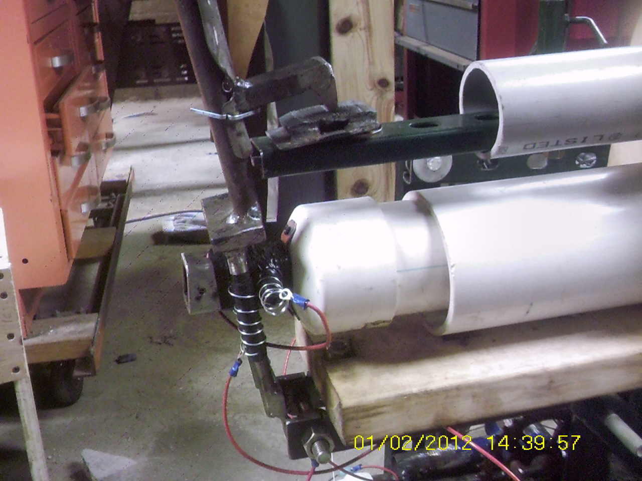

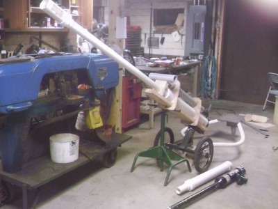

So I've been working on this howitzer. It's supposed to use shells instead of being muzzle loaded, so the system is fairly complicated which... complicates things.
Here's a load-out of my system:
-Spark plug ignition, which is an actual spark plug with the ground electrode ripped up so the gap is much larger.
-One barbecue button as an electronic initiator
-hinged "door" which completes the circuit upon closing
The pictures are gonna explain this a thousand times better than I am now. My problem is getting a consistent ignition. I've gotten it to work with light loads and small charges of hairspray, but I got nothing when I went to do a full blown test. I know I can get an arc using the spark plug and through my circuit, and I've tested the connections while the shell is in the tube.
SO since I've got a bunch of experienced spudders out there, I need some suspicions and suggestions. I have a few theories:
A) The door system I am using causes too much resistance, and the current at the spark gap is not hot enough to ignite large doses of gas
B) By spraying gas in the front of my shell, I am not getting the gas all the way to the back of the combustion chamber, thus the spark never gets near enough to ignite the gas
C) By spraying gas in the front of my shell, my spark plug is getting wet, shorting out... or rather unshortening, my spark gap.
My dilemma is I do not want to abandon my shell-fed system, nor my door. Yes, I could turn this thing into a regular spud gun, but I've already got one of those. This **** makes you feel like a redleg, haha.
Any help is appreciated

Getting the right mix of air and fuel is whats normally causing problems when manually spraying fuel in the chamber. You can't put more fuel in and hope for more power..
I suggest fuel meter of some sort, maybe fuel it with syringe using propabe or butane gas.

Cartridges are great if your trying to store a pre-metered fuel/air and you seal it off.
-Do you have a method of sealing off the cartridge? since you state you are using hair spray, I assume it's just a mixture of static air and injected hair spray, so there is no pre-ignition pressure over 1 ATM to worry about - you could get away with simply sealing the tip of the cartridge with saran wrap and a rubber band. I highly recommend using propane instead of hair spray as creating a mixture that will stay suspended is much easier.
I'm not a very big advocate of cartridges when it comes to using gaseous combustible mixtures though - simply injecting the gases into a static combustion chamber can make life a lot simpler and reduce your "load-out" significantly by not needing excessive materials.
